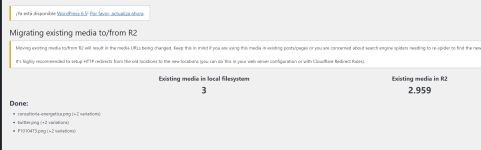

Mine remains at this after using rclone and migrating:
Any ideas? it is stuck in 3 existing media in filesystem. Rclone has synced everything already
Are you able to locate one of the 3 in the media library (they are listed there at the bottom)?
Can’t think of a reason that it would be skipping like that unless there was something internally wrong with those media items. If you pull up one of those media items in the WordPress admin, do they work (like can you see the images)?
