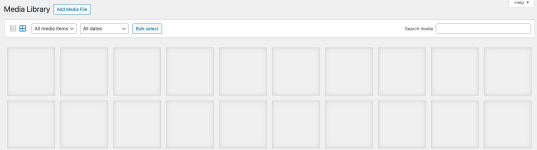

However, it looks like something isn't right with our R2 deployment. First, adding new media results in blank thumbnails on the media page:
None of my media files show a URL for static.domain.com anymore - they are all using my regular domain.com. I'm certain that the URLs have been using the "static" domain previously and have no idea when they would have reverted.
The site isn't broken because I have Cloudflare forwarding /wp-content/uploads to my R2 bucket, but media uploads aren't working correctly and all of the old URLs have reverted back to domain.com.
I'm not sure where to start on troubleshooting. The Migrate Existing Media doesn't show anything to migrate. If I browse my R2 bucket, there are files there in multiple sizes as I'd expect. When I upload a new image, it appears in R2 without having to use the Migrate Existing Media button. But none of my media library thumbnails are showing and the URLs are not referencing the R2 site.

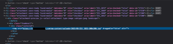

The thumbnails are receiving a 404 error when trying to access them (note that this is not the "static" URL, but the naked domain - but the redirect works fine and matches the URL that Cloudflare lists in the R2 bucket for the image):
Despite the fact that they are clearly in the bucket:

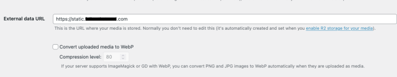

If you look at your Cloudflare settings page (the same place that you enter your API Token), what is the External data URL set to?
It almost sounds like that setting may have been removed/cleared out (if it doesn’t know what the URL of your public bucket is, it can’t point anything to it).
The external data URL is still set to the normal static.domain.com entry. All of my old media is still normally accessible at this domain as well (since I have the entire /wp-content/uploads directory forwarded, my site would be very broken if the old media were returning a 404 from Cloudflare):

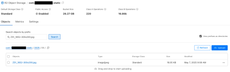

If I click the Migrate button, the file appears in Cloudflare:

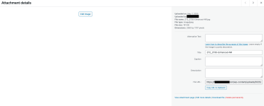

But it doesn't appear in Wordpress - also note that there is no indication of migrated or not here, or a storage bucket, and the URL still is domain.com instead of static.domain.com:

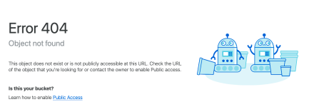

The image which is uploaded is also not publicly accessible - you get a 404 if you try to access the R2 storage URL for that image (by which I mean you can actually look up the URL in the Cloudflare UI and try to access it, and get a 404 - so there is no chance of a mistype here):
The last part doesn't make sense to me because every other item in that storage bucket is just fine; it's accessible to the outside world. It's only newly added/migrated items that are getting a 404.
None of the existing media have the "Uploaded to R2" or storage bucket indicators on their media pages.

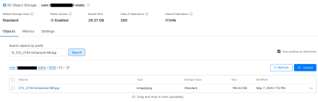

The file uploads in the media library successfully, I can see the status looks okay:
The image thumbnail in the media library is blank, though. If I inspect the thumbnail and grab the URL for the image, and I go into R2, it's there:
But accessing the R2 URL (the one published in Cloudflare) gives me a 404 error. If I use the download link in the media page, it downloads a happy image, I just can't access it:
I mean, this certainly - at first glance - looks like it's not a plugin issue since the file is there, and Cloudflare is giving me a 404 for a link that it provides me itself, but I can't replicate it with direct R2 uploads - only when the automatic transfer happens in the plugin.
