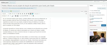

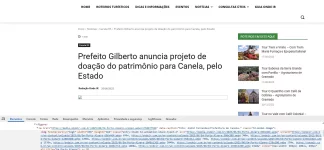

image error (local url instead of cloudflare's)
fassbinder

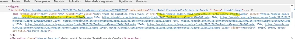

Is it only certain media images? There is some internal logic to determine if a srcset URL should be transformed or not. It goes through this (in this order):
  • Is there a R2 media bucket set
  • Is there an external URL set for the bucket (the public domain)
  • Is the image flagged as being in R2
  • Is there meta data for the image
  • Does the requested size variation (width) exist (as defined by the metadata)
If it's a specific image, it's possible that WordPress' internal record for the media is mucked (specifically the metadata). If the metadata record is missing or corrupt, it's not going to know about any size variations that exist. You can check the media metadata record by looking in the wp_postmeta table, and searching for meta_key = '_wp_attachment_metadata' AND post_id = xxxx (xxxx = the item number in the URL when you click on the media).
I found 3 recent cases.
analyzing the wp_postmeta table iI saw that it considered the image as "jpeg" when it was actually webp.
Even editing the file and changing it, it didn't work. I had to delete it and upload the image again.
Did I do something wrong when editing or is this the solution?
The file type as registered in the metadata isn't something the plugin needs to look at in order to generate the srcset URLs, so it wouldn't be that. That being said, it does seem strange that file type in the metadata was incorrect, but then correct when you reuploaded. Makes me wonder if you have some other plugin installed (or maybe previously installed) that could be playing around with media metadata for some reason and causing problems with it somehow. 🤔
It's the only image plugin I use: https://wordpress-org.translate.goog/plugins/webp-uploads/
It seems that the App for Cloudflare is not compatible with https://br.wordpress.org/plugins/performance-lab/ (there was already a previous error https://appforcf.com/threads/media-library-error.51/)
suggest making this clear in the plugin description...it may affect other users.
If you have multiple plugins doing image transforms when an image is being uploaded, it's probably best to pick one and use just that. For example if you have a plugin you like that is already doing WebP transformations, there's no need to transform it again with the option in the App for Cloudflare plugin (it's already been transformed by the other plugin).
In theory, it shouldn't cause a problem but I can't really speak for how third-party plugins do things internally (for example if a third-party plugin does a transformation and as part of that, moves images somewhere unique to that plugin, rather than the expected location where WordPress uploaded files are), it will be a problem if you want that image to also go to R2 (if something moves the source image, this plugin isn't going to know where it was moved to... it will just be "missing").
If images you are reuploading seem to be fine/working as expected, I'd suspect a third-party plugin that is going in and altering images after the fact (like a cron task or something). If images are already in R2 and a different plugin is going in to make changes to images, but it doesn't know how to retrieve from/upload back to R2, I could see it being a problem if that plugin doesn't gracefully stop what it's trying to do when it can't download/upload. For example maybe it can download the image (since it's a public URL, makes changes, but then fails when it tries up upload back to R2, but then it also makes metadata changes to that media). It's hard to say exactly what's going on, but there's nothing in *this* plugin that alters images after-the-fact... and it appears that might be what's happening if freshly uploaded images are fine, but then they "break" down the road somehow.
