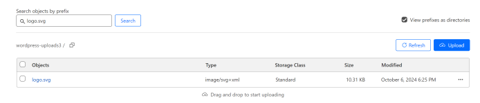

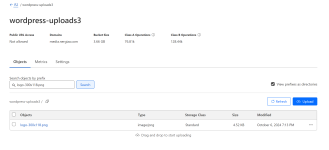

The 300x118 implies it’s an internal variation of something else. If you search Media for just “logo” does anything come up?
If you manually send it to R2, does it give you the orange cloud? Also, if you view the original image in question from the R2 bucket directly, is it a variation of that SVG?
I sent it using rclone, maybe that's why Wordpress didn't re-sync it? I don't trust the CLI script on the plugin because it didn't transfer all the images so I went ahead with rclone instead.
Not a big deal, I've replaced the image because it didn't worth the effort to troubleshoot it
Ya, the plugin relies on the image being where it’s supposed to be (in the local filesystem), so if something else moved it (like rclone) and it’s no longer in the local filesystem, it will skip it when trying to move it (skipping would result in the no orange cloud).
Basically if anything unexpected happens (the file doesn’t exist or if it ended up different on the R2 server), it will err on the side of not flagging it as successfully transferred.
